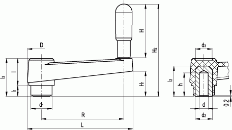

Korby z rękojeścią obrotową MT-AT - rysunek techniczny
ProduktRd%H9% [mm]L [mm]D [mm]d%1% [mm]d%2% [mm]d%3% [mm]l [mm]l%1% [mm]l%2% [mm]l%3% [mm]h [mm]H [mm]H%1% [mm]H%2% [mm]C [Nm]L#[J]
