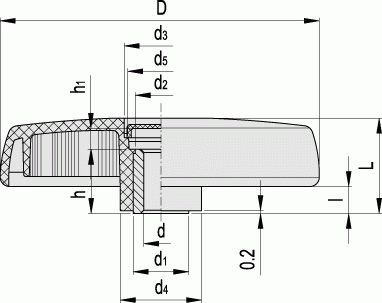

Koła ręczne pełne VDS. - rysunek techniczny
ProduktD [mm]d%H7%L [mm]d%1% [mm]d%2% [mm]d%3% [mm]d%4% [mm]d%5% [mm]l [mm]h [mm]h%1% [mm]t [mm]b [mm]C [Nm]L#[J]
