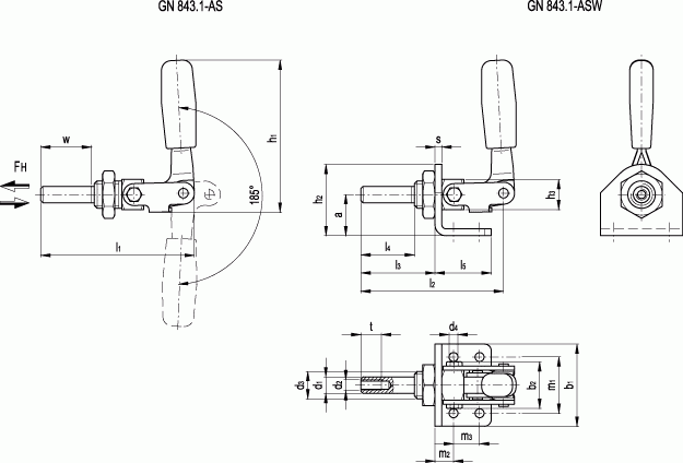

Napinacze GN 843.1 - rysunek techniczny
ProduktRozmiarF%H% w Na [mm]b%1% [mm]b%2% [mm]d%1% [mm]d%2% [mm]d%3% [mm]d%4% [mm]h%2% [mm]h%3% [mm]l%5% [mm]m%1% [mm]m%2% [mm]m%3% [mm]s [mm]t [mm]W [mm]
