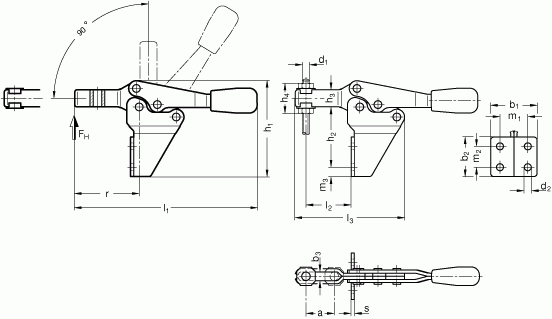

Dociskacze GN 820.2 - rysunek techniczny
ProduktRozmiarF%H% w Nb%1% [mm]b%2% [mm]b%3% [mm]d%1% [mm]d%2% [mm]h%1% [mm]h%2% [mm]h%3% [mm]h%4% [mm]h%5%maks.l%1% [mm]l%2% [mm]l%3% [mm]l%4% [mm]m%1% [mm]m%2% [mm]m%3% [mm]rs [mm]W [mm]
