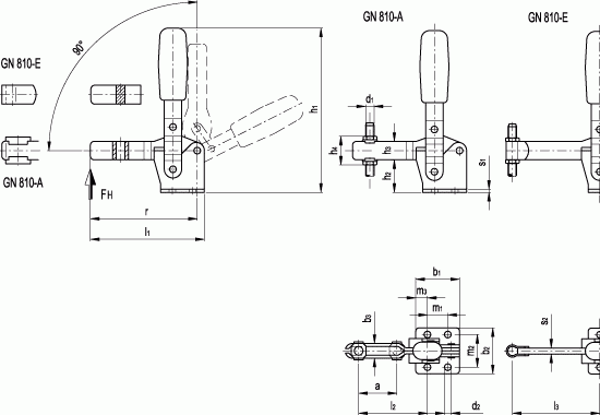

Dociskacze pionowe z przylgą poziomą GN 810
Dociskacze GN 810 - rysunek techniczny
ProduktRozmiarF%h%wNF%H% w Nb%1% [mm]b%2% [mm]b%3% [mm]d%1% [mm]h%2% [mm]h%3% [mm]h%4% [mm]h%5% [mm]l%3% %maks.% [mm]l%4% [mm]m%1% [mm]m%2% [mm]m%3% [mm]m%4% [mm]s%1% [mm]s%2% [mm]W [mm]
