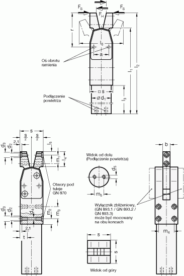

Dociskacze pneumatyczne GN 866
Dociskacze pneumatyczne GN 866 - rysunek techniczny
ProduktRozmiarF%H% w NF%S%wNa [mm]b-0.2d%1%h8d%2% [mm]d%3% %H%%8% [mm]d%4% [mm]d%5% [mm]l%1%-0.5l%2%-0.5l%3% [mm]l%4% [mm]l%5% [mm]m%2% [mm]m%5% [mm]rs [mm]t [mm]
