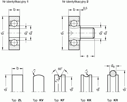

Rolki prowadzące GN 753 - rysunek techniczny
Produktd%1% [mm]d%2% [mm]d%3% [mm]d%4% [mm]d%5% [mm]d%6% [mm]d%7% [mm]d%8% [mm]b [mm]r%1% [mm]r%2% [mm]r3
