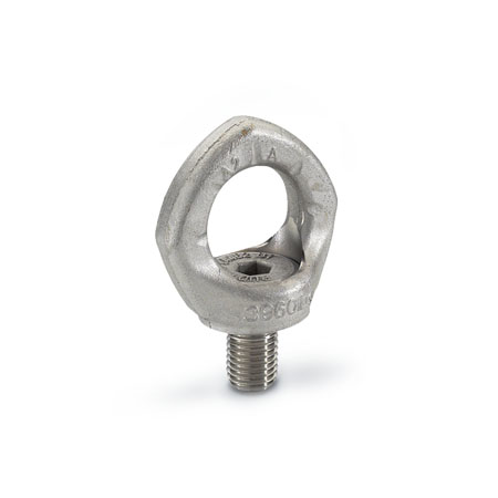

Śruby z uchem (obrotowe) GN 581.5

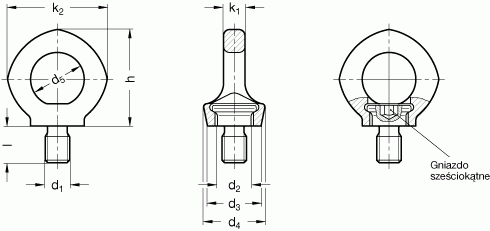

| Produkt | d%1% [mm] | d%2% [mm] | d%3% [mm] | h [mm] | k%1% | k%2% | l [mm] |
| GN 581.5-M12 | M 12 | 18 | 30 | 57 | 12 | 56 | 18 |
| GN 581.5-M16 | M 16 | 22 | 36 | 66 | 14 | 65 | 24 |
| GN 581.5-M20 | M 20 | 27.5 | 43 | 77 | 16 | 74 | 30 |
| GN 581.5-M24 | M 24 | 33 | 51 | 94 | 19 | 92 | 35 |
