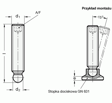

Wkręty dociskowe GN 632.1
| Produkt | d%1% [mm] | l [mm] | d%2%+0,05 | A/F |
| GN 632.1-M6-30 | M 6 | 30 | 4.5 | 3 |
| GN 632.1-M6-40 | M 6 | 40 | 4.5 | 3 |
| GN 632.1-M6-50 | M 6 | 50 | 4.5 | 3 |
| GN 632.1-M8-25 | M 8 | 25 | 6.1 | 4 |
| GN 632.1-M8-40 | M 8 | 40 | 6.1 | 4 |
| GN 632.1-M8-50 | M 8 | 50 | 6.1 | 4 |
| GN 632.1-M8-63 | M 8 | 63 | 6.1 | 4 |
| GN 632.1-M10-40 | M 10 | 40 | 7.8 | 5 |
| GN 632.1-M10-50 | M 10 | 50 | 7.8 | 5 |
| GN 632.1-M10-63 | M 10 | 63 | 7.8 | 5 |
| GN 632.1-M10-80 | M 10 | 80 | 7.8 | 5 |
| GN 632.1-M12-40 | M 12 | 40 | 9.4 | 6 |
| GN 632.1-M12-63 | M 12 | 63 | 9.4 | 6 |
| GN 632.1-M12-80 | M 12 | 80 | 9.4 | 6 |
| GN 632.1-M12-100 | M 12 | 100 | 9.4 | 6 |
