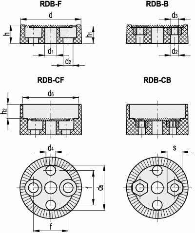

Pierścienie pozycjonujące RDB - rysunek techniczny
Produktd [mm]W min.C [Nm]h [mm]d%1% [mm]d%6% [mm]d%5% [mm]h%3% [mm]h%2% [mm]s [mm]Materiałf [mm]d%4% [mm]d%3% [mm]d%2% [mm]h%1% [mm]
