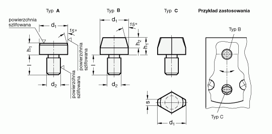

Kołki pozycjonujące DIN 6321
![Kołki pozycjonujące DIN 6321 - rysunek techniczny](https://www.ebmia.pl/c/6688_technical_drawing-tech_draw/kolki-pozycjonujace-din-6321.jpg)
Produkt | d%1%F7 | d%1%g6 | h%1%h9 | d%2%n6 | h2 | l |
DIN 6321-6-5-A | 6 | 6 | 5 | 4 | - | 6 |
DIN 6321-10-6-A | 10 | 10 | 6 | 6 | - | 9 |
DIN 6321-16-8-A | 16 | 16 | 8 | 8 | - | 12 |
DIN 6321-25-10-A | 25 | 25 | 10 | 12 | - | 18 |
DIN 6321-6-12-B | 6 | 6 | - | 4 | 4 | 6 |
DIN 6321-8-10-B | 8 | 8 | - | 6 | 6 | 9 |
DIN 6321-8-16-B | 8 | 8 | - | 6 | 6 | 9 |
DIN 6321-10-10-B | 10 | 10 | - | 6 | 6 | 9 |
DIN 6321-12-10-B | 12 | 12 | - | 6 | 6 | 9 |
DIN 6321-12-18-B | 12 | 12 | - | 6 | 6 | 9 |
DIN 6321-16-13-B | 16 | 16 | - | 8 | 8 | 12 |
DIN 6321-16-22-B | 16 | 16 | - | 8 | 8 | 12 |
DIN 6321-20-15-B | 20 | 20 | - | 12 | 9 | 18 |
DIN 6321-20-25-B | 20 | 20 | - | 12 | 9 | 18 |
DIN 6321-25-15-B | 25 | 25 | - | 12 | 9 | 18 |
DIN 6321-25-25-B | 25 | 25 | - | 12 | 9 | 18 |
DIN 6321-6-7-C | 6 | 6 | - | 4 | 4 | 6 |
DIN 6321-6-12-C | 6 | 6 | - | 4 | 4 | 6 |
DIN 6321-8-16-C | 8 | 8 | - | 6 | 6 | 9 |
DIN 6321-10-10-C | 10 | 10 | - | 6 | 6 | 9 |
DIN 6321-10-18-C | 10 | 10 | - | 6 | 6 | 9 |
DIN 6321-12-10-C | 12 | 12 | - | 6 | 6 | 9 |
DIN 6321-12-18-C | 12 | 12 | - | 6 | 6 | 9 |
DIN 6321-16-13-C | 16 | 16 | - | 8 | 8 | 12 |
DIN 6321-16-22-C | 16 | 16 | - | 8 | 8 | 12 |
DIN 6321-20-15-C | 20 | 20 | - | 12 | 9 | 18 |
DIN 6321-20-25-C | 20 | 20 | - | 12 | 9 | 18 |
DIN 6321-25-15-C | 25 | 25 | - | 12 | 9 | 18 |
DIN 6321-25-25-C | 25 | 25 | - | 12 | 9 | 18 |
DIN 6321-10-18-B | 10 | 10 | - | 6 | 6 | 9 |
DIN 6321-6-7-B | 6 | 6 | - | 4 | 4 | 6 |
DIN 6321-8-10-C | 8 | 8 | - | 6 | 6 | 9 |
