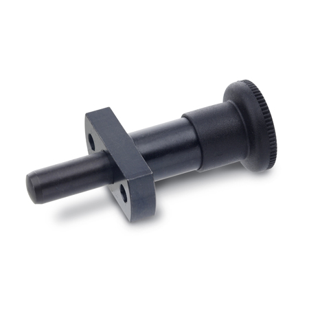

Trzpienie ustalające GN 817.3
| Produkt | d%1%h7 | l%1% [mm] | l%2% [mm] | l%3% [mm] | b [mm] | d%2% [mm] | d%3% [mm] | d%4% [mm] | k | l%4% [mm] | l%5% [mm] | l%6% |
| GN 817.3-6-18-B | 6 | 18 | 9 | 9 | 13 | 23 | 4.3 | 34 | 23 | 45 | 6 | 25 |
| GN 817.3-6-24-B | 6 | 24 | 9 | 15 | 13 | 23 | 4.3 | 34 | 23 | 45 | 6 | 25 |
| GN 817.3-8-20-B | 8 | 20 | 10 | 10 | 16 | 28 | 5.5 | 38 | 26 | 51 | 8 | 27 |
| GN 817.3-8-26-B | 8 | 26 | 10 | 16 | 16 | 28 | 5.5 | 38 | 26 | 51 | 8 | 27 |
| GN 817.3-10-24-B | 10 | 24 | 12 | 12 | 16 | 28 | 5.5 | 38 | 26 | 51 | 8 | 27 |
| GN 817.3-10-32-B | 10 | 32 | 12 | 20 | 16 | 28 | 5.5 | 38 | 26 | 51 | 8 | 27 |
| GN 817.3-6-18-C | 6 | 18 | 9 | 9 | 13 | 23 | 4.3 | 34 | 23 | 45 | 6 | 25 |
| GN 817.3-6-24-C | 6 | 24 | 9 | 15 | 13 | 23 | 4.3 | 34 | 23 | 45 | 6 | 25 |
| GN 817.3-8-20-C | 8 | 20 | 10 | 10 | 16 | 28 | 5.5 | 38 | 26 | 51 | 8 | 27 |
| GN 817.3-8-26-C | 8 | 26 | 10 | 16 | 16 | 28 | 5.5 | 38 | 26 | 51 | 8 | 27 |
| GN 817.3-10-24-C | 10 | 24 | 12 | 12 | 16 | 28 | 5.5 | 38 | 26 | 51 | 8 | 27 |
| GN 817.3-10-32-C | 10 | 32 | 12 | 20 | 16 | 28 | 5.5 | 38 | 26 | 51 | 8 | 27 |
| GN 817.3-8-22-C | 10 | |||||||||||
