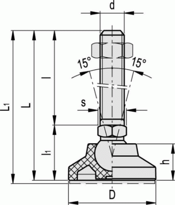

Stopy wahliwe LS.A - rysunek techniczny
ProduktD [mm]d [mm]L [mm]L%1% [mm]l [mm]l%1% [mm]h [mm]s [mm]
